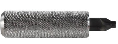

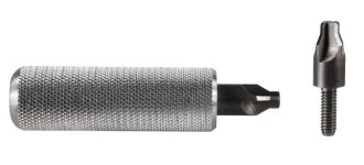

I currently use the Hornady reamers with a Trim-Mate powering them.
Once the reamer bottoms out it stops, so no loose pockets with easy primer seating.
I do recommend wearing a lightweight glove for better grip of the brass.
For me, I wish I'd never fooled with the swaging.
I ordered one kit and extra cutters, large and small.
Hornady Primer Pocket Reamer Cutter Head Small
Hornady Primer Pocket Reamer Package
Hornady Primer Pocket Reamer Tool Small
