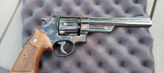

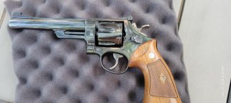

Well.. not a LC gun but a nice example of a ACP 4 screw gun from 1959. Needs to be cleaned up as the gun sat for awhile. The dull spots in the pics is the dirt and not the finish lifting.
