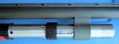

Here is a photo of my unfired Super12.
KO

KO,
Thanks for the pic. It agrees with the schematic that I have. I know that they are "supposed" to operate with all shells, but most of the comments I have found on these shotguns in my search deals with feeding issues. I am assuming that is the reason that there were two weights of rings in this gun.
Hopefully when I am able to get out to the range to test it, I will find that removing the second ring, which I am hoping the previous owner just slid on so it would not get lost, that it will function.
