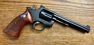

I know they're not everyone's cup of tea since they don't have the DA option, but I think this makes a nice addition to my collection.
A local auction house had an online firearms auction which ended yesterday. I'd gone to the preview last week to look over a few of the guns but didn't really pay too much attention to this one, as I already have several Model 14's (a K-38, and two 14-2's, actually-one of the 14-2's having the 3T's) and wasn't really looking to add another to the collection.
As it turned out, my bid of $400 won. With the buyer's premium, 3% CC fee, and $20 background check fee (I'm in TN, the state charges $10, the auction house charges $20 for the first, $10 for each additional gun on a 4473.), I paid $492, out the door.
Once I picked it up and got to looking it over more in-depth, I realized it's a single action only. Unfortunately, the factory box is missing the tag from the end, so I don't yet know if it's a factory SAO or if someone installed a conversion kit after the fact (or had a gunsmith do it without the kit). The serial number puts it as an early 70's gun, according to the SCSW 4th Edition.
I may end up forking over the money for a factory letter to determine if it left the factory as SAO. Either way, it looks pretty good (excepting the drag line) and I'm happy with what I paid.

That is nice, Rakkasan13F, and the price was excellent.
If the serial number is in the 3K or 5K ranges, let me know the first three digits after the K and I can at least tell you if it is in the serial range of known factory -3 SAO units.
It's 3K91192.

Well, yes, it is certainly possible.
The thing to keep in mind with all of my posts above is that, while we know ranges, that doesn't mean that all of the K-38 Masterpiece revolvers in that range were SAO. In each case, it takes a letter to know for sure. The fact that it is in the range increases the odds of originality. It guarantees nothing.
