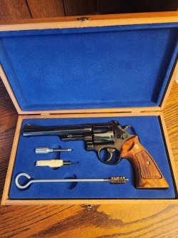

My Model 25-2 came new with cylinders for either 45 ACP or 45 Colt. When I bought it in 1982 it came with the 45 ACP cylinder installed. I left it in there. It gave stellar accuracy.
Then in 2010 I decided it was time to give the 45 Colt cylinder a try. I like it better - it may stay in there until the gun is for sale at my estate sale.

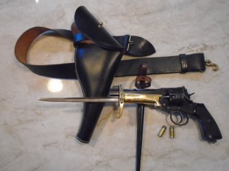

I purchased a 25 decades ago. Bought a passel of auto-rim brass. Loaded down for target work, the rounds are interchangeable in my 'shaved' Webley .455.

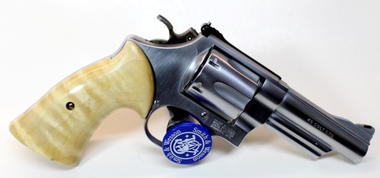

I have a 25-5 8 3/8" and a 25-9 4". I have a Ruger Vaquero with both cylinders. The 45 ACP cylinder has been fired 6 times.
The 25-9 was nickleless plated and I won some Kurac grips on the forum.

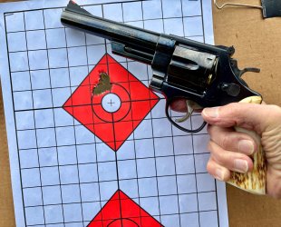

I have only done this once. I fired some 44 special in my 25-5. This is the target at 15 yds. Do not do this!
