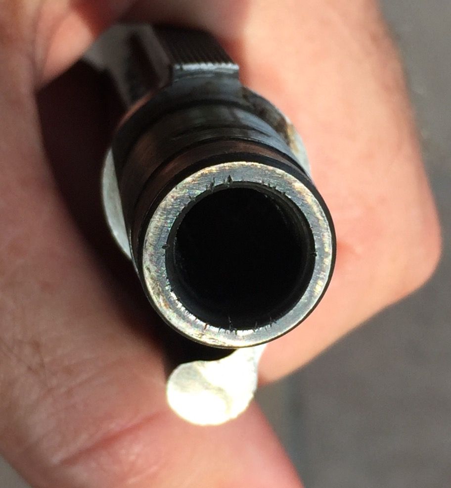

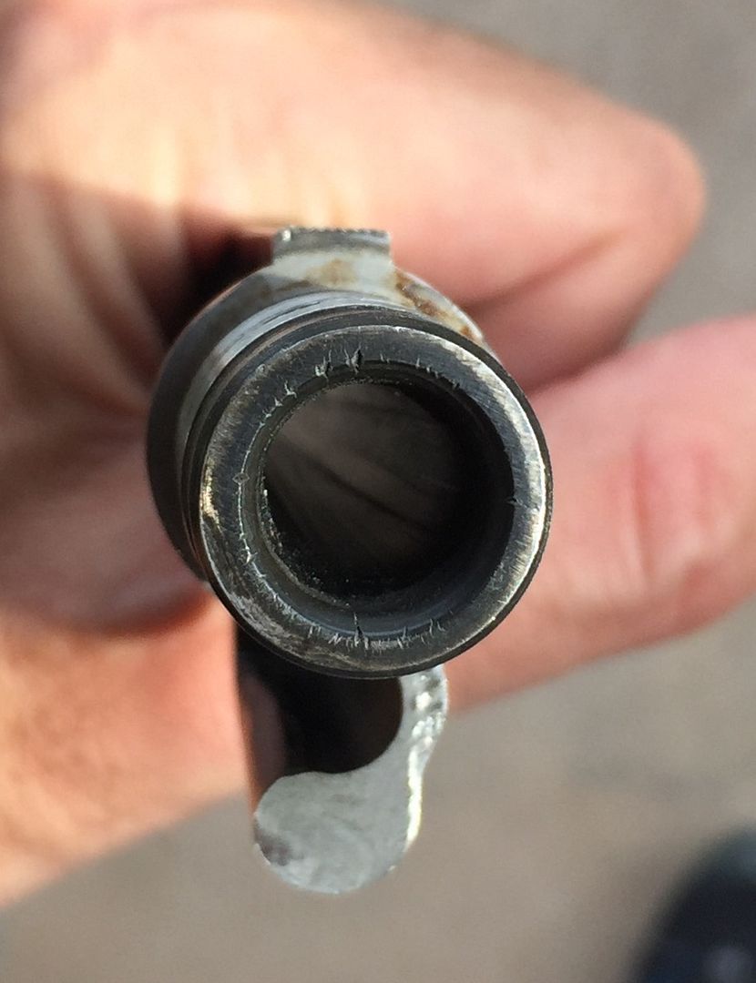

Model 27-2 forcing cone erosion
I picked up this 5" 27-2 from the original owner a while back. He said he bought it new in '73 (S/N N166164) and only put 200 rounds through it ...

So, I decided to go with the barrel swap. It's been a while since I've owned a 3 1/2" 27 and although this one's not an original, I have to say, it's pretty cool. Not sure what I'll do with the 5" barrel.
You made a great shooter, and looker. Care to post a picture of the FC before you start shooting it?

I think you have a 50+ year-old revolver that has been shot a fair amount; it also has moderate flame cutting under the top strap. My guess is a slow, hot powder with lighter weight bullets (110 and 125 grain). The erosion is there, but doesn't extend far on the back surface. I wouldn't worry about it, keep shooting it if it's mechanically sound. Refrain from lightweight bullets. They are shorter than heavier ones and even a fast powder is still burning when the back of the bullet passes the B/C gap. The flame front hits the rear of the forcing cone and top strap above the B/C gap. Measure your gap and check the cylinder for end play. Excessive end play can widen the gap.
My first 27-2 lived on 110 gr Winchester White box,, flame cutting of the top strap and erosion of the forcing cone, all part of thee fun... I'm a 158 grain man these days.
