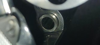

hello all, new member here looking for some advice. I have a 686 plus that has maybe 500 or so rounds through it. When cleaning it I have noticed what looks like forcing cone erosion around the top inside of the cone. I am new to firearms, this is my first, so I have no idea if this is normal wear or not. Thanks for any input.:)
going to try to post a pic hope it shows up.
http://smith-wessonforum.com/attachment.php?attachmentid=661183&stc=1&d=1704126420
It appears to have some erosion and some flame cutting. Perhaps it's the angle of the photo but the erosion appears only at the top of the barrel extension, the erosion I have observed was always uniform around the entire inside edge of the barrel extension.
Erosion
This is barrel erosion on model 53 barrels!
jcelect
Looks like lead build up to me.
Me too.
OP, is that material proud of the barrel extension, as in protruding? (Which would indicate build up.)
Or is it material missing from the barrel extension? (Which would indicate cutting.)
Can't be certain from your photo.
Me too.
It looks to me like the material is missing
Same here. The other 2/3 of the edge is sharp. Erosion is generally circumferential. Looks like you could scrape that off with a pocketknife. There is a bit of flame cutting under the top strap, but it's inconsequential and expected of a gun that's had a few hundred rounds through it.
Edit: After looking at an enlarged image, even the "cutting" looks more like a spray of lead. The inside of the FC is too clean and new-looking to be erosion or wear. Looks like the cylinder and barrel are minimally out of alignment (chamber higher than barrel), causing the lead to accumulate at the top, almost like shaving.
I have to wonder just how square the barrel shank is. Interesting that it is mostly located at the top. IF it is erosion, some powders are more apt to cause erosion than others. Slower powders loaded to give max velocity will accelerate it.
Maybe in another 5000 round it will be enough actually effect something.
Think of it this way if your buying factory ammo, 500 round probably cost about $350 or so and 5000 rounds about $3500. I do not know what a gun smith charges to remove the barrel, set it back one turn, face the shank back off and redo the forcing cone, but it only takes me a few hours. That gets you all brand new surfaces and only removes .0273 of barrel length.
My model 53 looked just like the one above. Now it looks brand new.
If you reload use faster powders and back off the velocity some. You can still fire full blown fire breathing loads, but what is the need for lots of them. If your into something like knocking over metal silhouettes and then bigger heavier bullets don't need as much speed.
Me too.

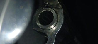

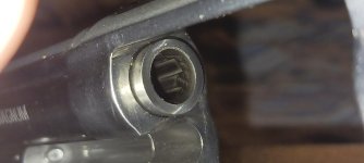

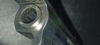

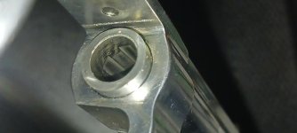

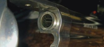

sorry I'm not a very good photographer maybe these photos are better
