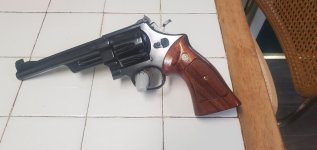

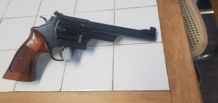

No dash 27
Does it look as good as this one. This is a no dash model 27 made in 1958. 6 1/2" barrel. Any no dash model 27 would have an "S" prefix and a six digit serial number. Did you get the serial number off of the butt. Early 50's "N" frames have five digit serial numbers and no model number. Five digit "N" prefix guns ran from 1970 to about 1973. You may be looking at a production number on the yoke and/or frame.
