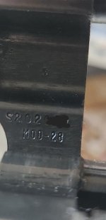

Model 28 No Dash
Very nice 4-screw.
Not sure why you felt the need to cover part of the assembly number in the yoke. It's meaningless after assembly. Only the SN on the grip frame bottom matters.
Very nice 4-screw.
It's the same number as the serial number on the bottom of the frame

Very nice, I can relate. My #2009xx shipped November 1959. It’s also very clean.
It inspired my N frame search and I just got my first 27, also a 4 screw. I can’t wait to shoot it.
Very nice 4-screw.
Model marked guns have the serial number stamped on the yoke. At the time of stamping the model number, S&W went from hard fitting to soft fitting. Assembly numbers were no longer stamped on the yoke.
My mistake. I thought the addition of the SN to the yoke came along later. I have very few early model number no dash Smiths (vast majority of my Smiths are much older).
So I just looked. Of my Model 22, 42, 64, 66, and 67 no dashes, only the 66 and 67 have the yoke SN.
Well, now I am confused. I have a 14-1, 15-4, 16-2, 16-4, 17-4, 19-4 and 28 no dash. All of them have the serial # stamped on the yoke. All my other K and N frames are pre models with assembly #s on the yoke. I do have a 31-1 and 32-1 (J frames) with no number on the yoke. Finally have a 642 (J frame) with serial # on yoke.
Not sure what the rhyme or reason is now. :(
