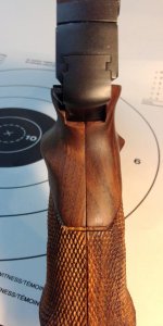

Grip remodeling results.
I finally completed my grip modifications and I am pleased with the result. Now the grip is comfortable and I get consistent sights alignment eyes closed. At the range, the trigger finger deviations are no longer noticeable with circular group dispersion.
I have removed the right side thumb rest, remodeled the upper area to prevent contact with the trigger finger and removed material in the upper right rear area to shift my natural sight alignment to the right. Filing the wood to get the proper shape was relatively easy. These modifications works well for medium size hands like mine.
Refinishing the grip was more time consuming since the original grip was finished with a clear varnish that I had to strip before refinishing with oil.
I attached a few photos to illustrate the new shape.

Nice work Targetfan...What did you use to remove the wood? Just sanded down by hand? How did you remove original finish? I am looking to do something similar to my factory grips. Any tips or lessons learned would be appreciated.
Working tips
I used a wood rasp to remove the top of the thumb rest and finished the curved shapes with small files (see photo). Considering the amount of wood to be removed I do not recommend the use of motorised tools like a Dremel, you can save a few minutes but it is much more difficult to model the shape and you risk to make dents.
Remove the pressure points of your trigger finger on the side, then check your grip natural angle (sights aligned, eyes closed), removing material in the upper back side area will shift your aiming point to the right. For sights alignment remove small amount of material at a time and check often. Protect checkering with masking tape while filing.
Once you are satisfied with the shape, you remove the varnish with a paint stripper preferably water soluble (a few coats are necessary) incomplete stripping will produce unaesthetically uneven wood color. Use a tooth brush so you do not damage the checkering.
Once rinsed and dryed, remove file marks with fine wood sand paper (grit 80-120) and polish with wet or dry car paint sandpaper wetted with your favorite wood finish oil (linseed, tung) grit 320-400 for matte finish and complete with grit 1000 if you want a glossy finish. A few coats of oil will saturate the wood and will provide a nice finish. I use the end of a tooth brush handle to hold the sand paper; get one that is covered with silicon, it does not slip on the sand paper back and produce an even finish.
I added a photo of the rasp, files and tooth brush. The most useful file is the round/flat (second from left). Hope this help you. Have fun with your mods.
