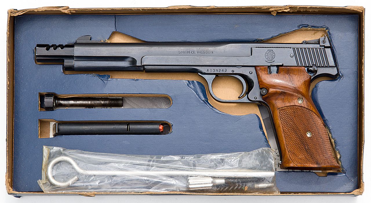

The older Model 41 with the 7 3/8" barrel and muzzle brake has a threaded rod that serves as an internal weight and has a hole in the end for the brake to attach to. The rod screw into the barrel, and appears to have 3/8 fine threads. Can anyone confirm this?
Correct Tom, threads measure .375 on weights but I am unsure of pitch. I may be able to gauge if necessary as long as they are not S&W specific. The shoulder screw attaches cap or brake to the weight. Mine is circa 1965, muzzle brake, cap, light and heavy weights.
Thanks Mike. I took a chance and used my 3/8 NF tap through and it worked great. Then I took a file to the steel weight as I don't have a 3/8 NF die, to clean up the damaged thread on the end of the weight and **magic** everything works like it should!
