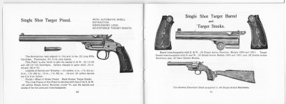

I replied to a question on the SWCA Member side about the 38 Single Action revolver and its association to unnumbered single-shots. I am attaching the images that ran in the 1900, 1903, and 1906 catalogs and a price sheet from a 1906 catalog. I had to reduce the quality to post here so ther image is a little fuzzy. The target sight is midway down in the right column and the barrels are in the lower right corner. at least three years of catalogs had the same single shot pages and offered them for sale. Barrels and target sight/latches were available from the factory for at least 6 years, plus we know that many barrels were still left-over and ultimately sold off from the factory in bulk lots. I agree with Ralph that if the gun does not have standard serial number stampings, it is unlikely it's original. Back then you needed a letter, postage stamp and $9.75 to order the barrel and target latch directly from the company. I also guess that large distributors ordered barrels to either sell or assemble their own Single Shots.
Ralph - is there any evidence that the factory ever removed recoil shields to sell as 2nd Models?
