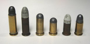

For shooting I thought my best bet was the machined .32 Long cases sold by Dixie Gun Works. The comparison cartridge picture shows a 32 S&W CF Long and a 32 S&W (short) at far left and far right, resp. Second from left is a 32 Rimfire Long and second from right is a 32 Rimfire Short. Center left and right are machined Dixie long and short cases loaded with a 0.310 round ball. You can use a .22 blank as a primer in the offset hole machined in the Dixie case. Then fill the case with black powder, I used Pyrodex P, and seat a 0.310 lead round ball in the case mouth. Cases with this load worked OK. In fact, it was a fire breather sending the ball down range at better than 1000 fps. Accuracy was so-so. The group I show was fired at seven yards. Using these cases is tedious and they are too heavy to obturate so blow-by turns a case completely black upon firing. Also, the smallest ding in the case mouth makes it hard to seat a ball. Anyway I got the experience I wanted and I do not intend to shoot this probably tender antique very much.
