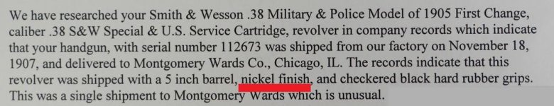

I do not want to set a precedent for folks believing that the B mark on a nickel gun is often wrong, but it sometimes is!
That gun looks like it has a FACTORY original nickel finish to me. ;) Only a letter could tell us for sure.
It is believed that the Factory occasionally pulled a blue gun from the vault and nickeled it to fill an order when they had none in stock and were not currently running that model.
It is also possible that a gun which was already marked "B" was diverted from the blue batch to be nickeled. MAYBE they forgot to leave the B off of some of the guns currently being built, or MAYBE they received orders for more nickel guns than they had planned on building.
REMEMBER- this is a RARE occurence. MOST guns marked with a B left S&W as blue guns, and there are only rare exceptions!
Want some proof? :D
L@@K----

I forgot to add a couple of more points-
The sideplate screws are almost certainly replacements.
Since the original grips still fit about perfectly, it is very unlikely that the gun was buffed after leaving the Factory.
There are no Factory rework marks and the finish looks like a Factory finish, so I think it is a very good possibility that the gun originally shipped in nickel.
