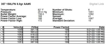

Had more fun with the chrono today. Still working on my 158gr FBI type load but in 357 brass. I think I am done. I dropped down to 8.0grains of AA#5 and the average was 1056fps. So I think that is about where I want to be and coincidentally, it is low end of the load range as listed in Wester Powder V8 for that bullet and powder in 357mag. It wasn't with the actual hollow point g/c bullet but the less expensive LSWCs which I use as a stand-in for the hollow points. Here is the chrono summary

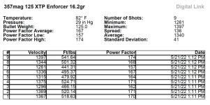

Even more fun was testing some rounds using Enforcer with the 125gr XTP bullet. The range is 16gr to 18 gr. I started near 16gr and measured an average of 1340fps. I actually had 12 shots but some of them were crazy high like 9000fps. That must be some glitch with the chrono which I have not see before. Maybe I was too close. Anyway, that bullet is rated up to 1500fps so I am going to bump up to 17gr and probably call it good. Got to say I really like the sound these rounds make. Definitely more of boom than a crack and shot with my 686 Comp, the recoil was no big deal :D
Chrono data with the weird super high ones deleted.
