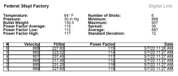

The results are in. First I shot six commercial rounds as a control. These were Federal AE38K. The box says 130gr and 900fs.
My average was 887fps so I think that is very close. Full chrono report.....

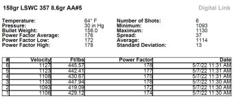

Next I shot six of my lower cost builds I will use for practice.
158gr LSWC in 357mag brass, 8.62gr of AA#5, and Federal SP primer. I was trying for 1100 actual with load data suggesting 1150 or so. The average was 1114 with a standard deviation of 13fps. I think I pretty much nailed it.
Then I shot 12 of the same load using the 158gr g/c LSWCHP. The average was 1110fps with a standard deviation of 25fps. So basically the same as the cheaper bullet.
I'd say my experiment was a huge success. Both loads produced a PF of 175 so the cheaper bullet will feel the same as the expensive bullet for practice. Some of the talk about leading with the soft HP bullet had me a little worried but as far as I could tell, I didn't see any. I think the speed is maybe just a little hot for what I want as a long term load to make so I will back down to 8.3 gr and see what I get why that. I appreciate all the other powder ideas but seems like AA#5 is working and it's available. The only other thing I'd like to try in the near future is a "full power" 357 load with a 125gr xtp bullet which I also have. I will get Enforcer powder for that. The loads I shot today were average PF of 175 and they were easy to shoot with my 686 comp. Full speed with Enforcer and a 125xtp would be PF=208. I see a lot of posts suggesting the full power 357mag loads are hard on recoil. I want to see for myself :)
