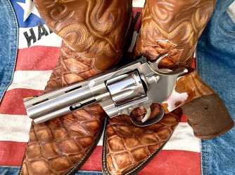

I've got two of the "new" Python's also. A SS one and Blue. Both 4.25". I have a "thing" for a "4" revolver. No idea how many rounds I've fired through them, but they've mostly been 38 Wadcutters. Quite happy with both. I actually like the grips. The original Python grips (I had one) felt like a wood rasp, especially when shooting magnum loads.
Hey, you stole my guns! 😃 I own two just like that. Beautiful firearms and a pleasure to shoot. Enjoy.

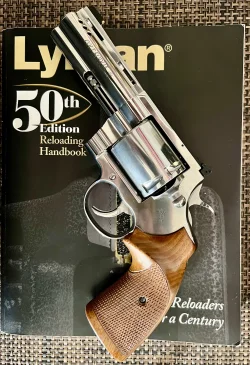

Just purchased a new 3" stainless Colt Python.
I'm a S&W guy and had no plans to get a new Colt. I became enamored after handing this gem at the local gun shop counter. Enamored.
Fit and finish is immaculate. The double-action is very impressive, real impressive. The single action is a bit heaver than expected but nothing terrible.
It looks like Colt actually cleans the revolver after the test firing. I like 3" revolvers and I'm certainly dazzled with this one.
