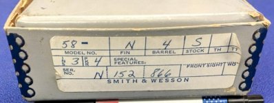

Mine is from 1972-1974; so, 7-9 years newer if yours was made in '65. I don't know if they changed the style of box and stocks during that time; but if not, this is what it should look like. I traded for mine and it was LNIB. I do shoot it and it is my favorite S&W revolver. Hope this helps.

Nickel M58's aren't rare, but are much less common than blued ones. SCSW gives a 10% price premium for a nickel gun vs. a blued one in like condition.
This is what a set of period correct stocks would look like, as 22hipower has already identified. Yours is possibly a second year model, the M58 was first released in 1964. The one below is from 1968 and yours would have the diamond around the escutcheon like it does. I also included my Letter, it gives the history of the Model 58.
