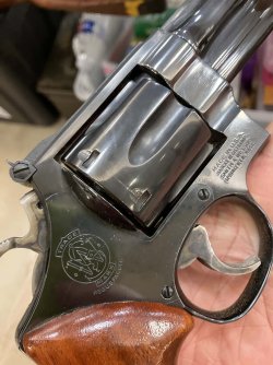

I recently got this .44 Special and since I mostly shoot cast bullets, first thing I did was check the throats. They are very consistent but drop through a .432 pin gauge (.433 is a no go). These seem way too fat to me. Am I missing something? I don't have a mould that casts that fat as far as I know. Might get to .432 with powder coating and casting really soft lead might help.
Has anyone had accuracy issues with these revolvers or do they just shoot great with the fat cylinder throats?IMG_1799x.jpg

Your best bet is to just shoot it first, the larger throats might not make any difference.
I bought one from Toad67, a great guy. We agreed I might have put the first shots down the barrel but it hasn't seen many. I just shot it enough to see it's accuracy potential.
Some commercial casters will throw a 432 bullet for you. Worth a call.
