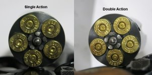

However, the difference between primers firing and not firing has been the difference between single action and double action. The static force as measured doesn't change between SA and DA. So its a good reference point, but doesn't tell the whole story.
