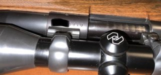

The few Douglas barrels I have owned had the info stamped around the chamber end of the barrel, like in the photo.

The 'smith may have marked/signed their work in the inletting.
They usually like to take credit even if discreetly.

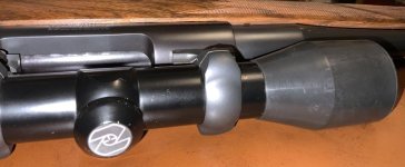

I looked at the chamber end and didn't see any markings. This is the best photo I could get...
As I mentioned before, I'm reluctant to pull the action because of the tight inletting. The barrel is free-floated and it may be glass bedded.
It closely matches the contours of a Douglas Light Sporter, but it could also be a Shaw or Shilen. I'm sure it's not a Winchester OEM barrel.
It measures .590" at the muzzle, but is only 18-1/2" long.

The bbl is 'glass' bedded from the breech end forward at least the length of the chamber area of the bbl.
You can see the thin sliver of bedding material on either side.
That's a common area to bed along with the recv'r ring and the recoil lug.
The rear tang is likely glass bedded as well. The two areas are generally done together.
The socket head action screws make it easier to disassemble w/o the chance of marring anything. But unless the need to look inside is so overwhelming that you just can't stand it, there's probably no good reason to tear it down to look.
