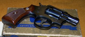

That’s a 5-screw .38 Special M&P revolver. The serial number should be on the butt, the back of the cylinder, the barrel flat over the ejector rod, the yoke arm (align one of the cylinder chambers with the arm and shine a flashlight from the side), on the inside of the right stock/grip panel and on the back of the ejector star.
I suspect the stocks have been replaced and won’t match. Yours are probably from an earlier M&P or an adjustable sight K-Frame. By this time, S&W was supplying M&P revolvers with PC (plain clothes) or “modified Magna’s, that had a rounded edges on the sides of the butt.

Nice M&P Snubby
Very nice 2" bbl M&P revolver you inherited- your grandfather had good taste. These have become very desirable to collectors recently, and the values are rising quickly. The Pachmayr grip adapters (and those by other manufacturers) are popular with folks that shoot snubby revolvers with smaller stocks (grips). My wife's grandfather was a LEO in California in the 50s-70s, and he liked the Pachmayr adapter on his Model 15-2.
