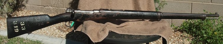

Just be sure to do a better job than Carlos did on this Mexican 1910 shortly before he threw it into the barbed wire near Nogales. Click for fullsize.
