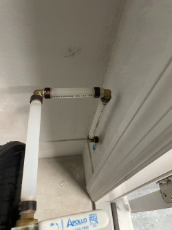

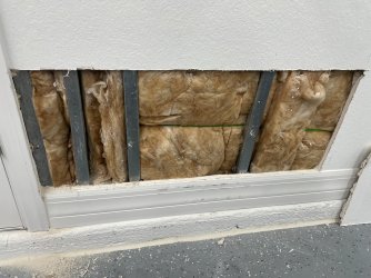

Here in SWFL AC drip lines are always getting clogged up with the goopy stuff. It's actually a form of bacteria and it clogs the drip line which in turn causes the float switch to automatically turn off the unit until it is cleaned out. Of course this never happens at a convenient time - always at 2am or when you have a house full of people - or even worse..... when you are away! It has happened during a downpour and cleaning it out with a shop vac from the outside is a royal pain in the butt!!
About 2 years ago I had a semi manual system with a hose connector on the inside line and that would get flushed out with a garden hose. That worked well, but I had to manually run the hose into the garage where the ac closet is located. No big deal but I was looking for something super simple that even my wife would not mind doing. Well today I did it!

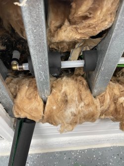

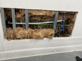

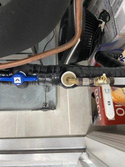

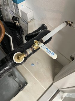

I cut the wall, found a cold water line, ran PEX from the cold water line into the ac closet and hooked up a ball valve directly into the drip line. Now all I need to do is to turn off the drip line flow valve and open the water supply valve. Run the water for 45-60 seconds and done! Don't even have to go outside now.
Tomorrow I will put the insulation back up, rehang the same sheetrock, spackle and paint. That should not take very long. Luckily I did have a cold water line about 3 feet from the ac unit closet so it was very easy to do this. If you have a similar set of circumstances it might be something you should think of doing. The total cost for all the PEX pipe and fittings were $33 and it took me about two hours to do. Figure another hour to do the repair work on the wall and that's that. I have spackle, tape and paint so no outlay of money there. Works like a charm!!

I have tried the enzyme from the same company but in the bar form. When I service the air handler every 6 months I put one of the slow dissolving enzyme bars in the drip pan. It is supposed to last up to 6 months and helps somewhat but it's not perfect. The water flush with full house pressure pushes everything out now that all I have to do is turn two valves it will take exactly 60 seconds. I will do that religiously once a week and that will keep the line snot free forever, I hope!
The shop vac method is IMO a poor method of cleaning the line out because after the water level in the pan drops in a few seconds, the vac is just sucking air through the line and isn't doing much cleaning action. The water flush really pushes everything out.

I know - that is why this high pressure water flush system works so well. My days of using a Shop Vac for this purpose are over.

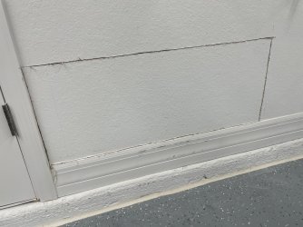

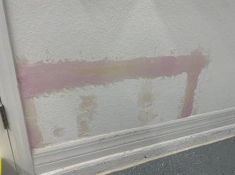

This job took me about 2 hours and $33 to do. It wiil take me another 1 1/2 - 2 hours to spackle and paint. Then the ease and enjoyment of doing a task nbo on e really like to do becomes a cinch.
Here are the two final repair pictures. One after the first coat of joint compound and the other complete. I did my best to match the texturing on he sheetrock and it came out fairly descent - for my first attempt at texturing.
