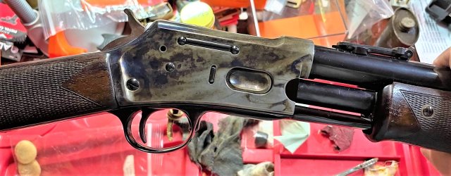

A few years ago I bought a Pedersoli Colt Lightening in .45 Colt at an auction. Bought it for $900, when a new one was advertised as costing $1800.00. Shortly thereafter Pedersoli stopped production. Got it home and had problems with the rifle feeding ammo from the magazine. Asked questions all over, with no real help in fixing the problem. One gentleman sent me a shop manual and I tore the rifle down and looked for a problem. No joy, so into the back of the gun safe as a future project. All that changed last week. Received the new "GUNS" magazine and lo and behold there was an article on a new Pedersoli pump rifle. In the article it stated there were there was a problem in that Pedersoli copied their older pump after an original and that present day .45 Colt was to long. The original .45 Colt was a meplat bullet (read flat point) and therefore shorter than present day .45 Colt with round nosed bullets. Also found a discussion on another forum the rounds for the older Pedersoli needed to be 1.5" to 1.55" in length. For some reason the action should be open when loading and to push the rounds well up into the magazine using your "Pinkie" finger. Made some ammo up to the stated OAL and took the rifle to the range this morning. It worked as advertised!!!! Now I have another new toy to take to the range to shoot.ColtLightning1.jpgColtLightning2.jpgColtLightning3.jpg

You would have thought that the engineers that copied the rifle would have checked the dimensions of the .45 Colt rounds as manufactured today. But obviously not, also that the company would have put something out referring to this instead of just ceasing production. Have never looked at overall length of currently manufactured ammunition, when buying it for a firearm in current production. Considering that if it fit in the chamber on a revolver it should fit into the loading mechanism of the rifles. Fouling has nothing to do with fitting in the chamber. It is about fit between the cylinder and the forcing cone. Since there is no forcing cone in a rifle chamber this fouling should be a none issue on a reasonably clean firearm. A long time ago a friend and I shot our M1911's until they quite working from build up from lack of cleaning. We got up to 2500 rounds before the pistols quit.
When all is said and done the problem with the rifle was a lack of attention to detail by the engineers who copied the rifle from the original.

Fouling has nothing to do with the rifle problem. Yes, fouling had to do with the cylinder movement in an SAA (revolver). It is the build up of fouling (burnt powder) that impedes the movement of the cylinder with the forcing cone. This has nothing to do with a rifle.
The problem arises for the OAL of the new .45 Colt cartridges vs the original .45 Colt cartridges. Also the lack of redesign to take in account for the straight walled pistol cases.
The point shape of the bullet in this rifle has to be flat. In every other rifle that I own not so much if at all. Usually a pointed bullet will feed easier in a rifle, unless the OAL is to long. Lever guns can feed a pointed bullet if the OAL is correct. Case in point is the Model 1895 Winchester https://www.google.com/search?q=cal...CCLACAfEFpHIvWpaG98Q&sourceid=chrome&ie=UTF-8 Also now the Leverevolution rounds.
Bottom line is the rifle now works as it should and is a hoot to shoot. Fits in well with my S&W Model 25-9 and my Ruger Vaquaro.

I use to own a Colt M1909 U.S.Army at one time. I also had my 25-9 and the Ruger Vaquaro. So when someone offered me twice what I had paid for it, they owned it. The round for the M1909 has an OAL to long to work in the Pedersoli. Right now I am using a 200 grain RNFP, and seating them deeper than I normally would to get the OAL down to 1.50-1.55.

A few years ago I bought a Pedersoli Colt Lightening in .45 Colt at an auction. Bought it for $900, when a new one was advertised as costing $1800.00. Shortly thereafter Pedersoli stopped production. Got it home and had problems with the rifle feeding ammo from the magazine. Asked questions all over, with no real help in fixing the problem. One gentleman sent me a shop manual and I tore the rifle down and looked for a problem. No joy, so into the back of the gun safe as a future project. All that changed last week. Received the new "GUNS" magazine and lo and behold there was an article on a new Pedersoli pump rifle. In the article it stated there were there was a problem in that Pedersoli copied their older pump after an original and that present day .45 Colt was to long. The original .45 Colt was a meplat bullet (read flat point) and therefore shorter than present day .45 Colt with round nosed bullets. Also found a discussion on another forum the rounds for the older Pedersoli needed to be 1.5" to 1.55" in length. For some reason the action should be open when loading and to push the rounds well up into the magazine using your "Pinkie" finger. Made some ammo up to the stated OAL and took the rifle to the range this morning. It worked as advertised!!!! Now I have another new toy to take to the range to shoot.View attachment 784865View attachment 784866View attachment 784867

I tried to make them as short as possible. I used a 200 grain round nose flat point cast lead bullet. I made them at 1.5 inches. Make sure you put a slight crimp on them. I usually don't crimp much as I was using them in revolvers. HTH!
