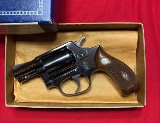

I recently acquired this pre-M36 and simply wanted to share it with others - I'm excited! I'd been looking for one for a while and I'm happy with this find. I referenced J. Supica and R. Hahas' Standard Catalog of S&W 2nd ed. and assume that this was manufactured in 1951 or 1952 based on the serial number (404x). The same four-digit serial number is located on the bottom of the barrel, cylinder, on the inside of both grips, and butt. The yoke does not have the model number. It's got a smooth ramp without serrations. I count 4 screws visible including the one on the front of the trigger guard. No box. I'm assuming it's a pre-M36 also known as a Baby Chief?
I'd love to hear back from anyone on their thoughts.

I missed the screw under the grip - This is a 5-screw version. And, I stand corrected, the serial number is stamped only on the inside of the right stock.

Crazywader, the Baby Chiefs Special you opened the discussion with is a handsome piece that many of us would be very happy to own.
You have a 'pre-model' in the sense that it was manufactured prior to model numbers being assigned..... but, in collector speak, a true 'pre-model' is one that was made prior to, and in the same configuration of, the model marked ones. Using that criteria, no Baby Chiefs is a 'pre-model 36'. The baby Chiefs Special you have was several iterations prior to model numbers being assigned. e.g. yours is a 5-screw, with the smaller butt frame, and the round (not egg shaped) trigger guard. After your Baby, there was a Baby Chiefs with a serrated front sight (all Baby Chiefs were 5-screw). Then came some changes; the frame grip size became 1/8" longer, the trigger guard was elongated (to egg shape), and the screw count dropped to 4 with the elimination of the trigger guard screw. These modifications are often called the "Model of 1953" changes. This is when the Baby Chiefs 'grew up'....... Shortly thereafter, the large screw at the top of the sideplate was eliminated making the Chiefs Special a 3-screw model. There were 3-screw non-model marked ones produced. These would be a 'pre-model 36' to the purist, as the model marked Model 36 was in this same configuration.

It appears ...Chad and JH... have answered most of your questions regarding what folks call your Chiefs Special. I will continue to call it a .38 Chiefs Special with a five-screw frame.
My database lists many serial numbers Messrs. Supica and Nahas did not have access to for those early editions of their fine tome.
The five-screw carbon steel Chiefs Special serial range is 1 - almost 46000. In that range I've estimated about 6,000 numbers are aluminum alloy Chiefs Special Airweights.
Smith & Wesson neither produced nor shipped Chiefs in serial order so you must be skeptical about serial and date ranges. The sole way to know the exact day yours departed the plant is to obtain a letter.
The serial number spread shipped in 1950 includes 6 - X59, 1951 includes serials 1 - 1825. Carbon steel serial numbers shipped in 1952 span 132 - 24825, and a number of Chiefs Special Airweights shipped in 1952 also.
Ah, the thumbpieces. You're looking at long out-of-date details in the older copies of the Catalog. One of my displays at the June 2025 Smith & Wesson Collectors Association symposium in Concord, North Carolina, portrayed thumbpieces the company used on Chiefs Specials from 1950 - 2025. I showed seven variations of the flat thumbpiece in my display. The first one had a short lifespan, and we had only seen it on serial numbers 16, 34, 99, and 101 (1950/51). History can change quickly. I saw serial number 54 in Concord, and it has the first flat thumbpiece. This month I've now seen serial numbers 10 and X58 (the second and third Chiefs Specials to ship in December 1950), and they also have the first flat thumbpiece. A gambling man might wager there are more.
Known second flat thumbpieces--like your plump oval thumbpiece--span serial numbers 111 - 36722 (1951/53).

Something else I noticed and believe to be true about your gun……
I think your grips have the plastic medallions which are scarce and happened about 51/52
Here's pics showing metal and plastic side by side.
If you ever have the grips off and yours are indeed plastic, be careful around the rivet head as it is plastic too and can break off.
(Your grips look beautiful and don't need restoration but people have ruined this style in past from soaking them in acetone)
