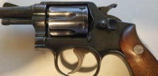

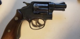

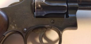

I'm a semi-automatic guy, generally, so bear with me please. I have what appears to be a pre-Model 10 K frame revolver. It's a hand ejector 5 screw with strain screw and fixed sights. The serial number is long gone...I've looked on the butt and front strap, and removed the wood thinking that it may be hidden there. The only numbers are the assembly numbers.
Upon looking at the butt closer, it appears that it once had a swivel that has been ground off, and the ghost of only two numbers remain. The bluing on that surface matches that of the rest of the pistol, so I'm betting the firearm was worked on many, many moons ago.
I've added a few photos to help you help me identify a range of years in which this could have been made. Also, how would I go about being able to legally transfer this without the serial numbers?

Ouch. What you have there can be legal trouble.
It was almost certainly an M&P from the WW II era, most likely the British Service version originally in .38 S&W. The barrel has been cut and the gun scrubbed of markings and refinished.
Other potential locations for the serial are under the barrel and on the back face of the cylinder; harder to see can be the ones on the back of the extractor star and the back side of the yoke arm. But only the butt holds the legal frame serial.
You would not be able to legally transfer it; technically, you cannot legally own it. I don't give any further legal advice; others probably will. But just from the gun's value as such, this isn't a gun worth any risk.

Yes. I think we can say with a high degree of confidence it is a chopped BSR. Moreover, you can see the serial number on the barrel flat in the first three pictures, so open the cylinder and look on the underside of the barrel. Serial number will probably start with the letter V.
The best thing about this revolver is the stocks. They are from after WWII and probably started out with checking. But they still actually look pretty good. They are not original to this revolver.
Too bad about the serial number. I don't think there is anything you can do to make this a legal gun. It certainly cannot be legally sold.
Technically, it is not a "pre-Model 10." It is a bit too old for that. Those start in about 1948, with the introduction of the high speed hammer. But you can correctly refer to it as a predecessor to the Model 10.
Method to make removed serial #s reappear:
1. This can be done with nitric acid, or "nicodate" sold in coin shops. After application, the # will magically appear. It's actually exposing the compressed metal from the stamping appear in a contrasting darker gray to the surrounding metal.

I would definitely say that the work done to the 38 is pre-1968. I have a friend in forensics that further developed the acid process, even wrote a book and developed kits to assist. I might call him in and see if we can raise the numbers from the dead.
Darned shame to find this one, though. Action is crisp and has good lock up. The work done, while not the cleanest, isnt bad.
Look under the barrel flat and on the rear of the cylinder above the chambers. Prior to 1968, no serial number was required anyway. I think you are fine but many will get crazy about it.

The serial is erased , the ejector rod locking lug wound up on someone's shop floor , and it appears that the side plate is misfit.
Parts gun in my book. Nice grips anyway.
