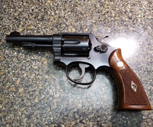

I have S 8687xx I believe dates to Nov 1946.
So, if March or April 1946 was the date on the first S Prefix(s)
A reasonable assumption. If you want a more precise shipping date for yours, you could have it lettered. Many here would identify yours as a “postwar M&P.” A civilian M&P with the improved hammer drop safety and long throw action. Some will call it a “Transitional” M&P but I personally prefer to avoid the use of that imprecise term. It applies to M&Ps up to SN ca. S990xxx, at which point the short action (high-speed hammer) was incorporated.
I have a number of M&P units in the S868000 range that show up in my database. The earliest of them shipped in January 1947. The latest shipped in September 1947. Most of the earlier shipments in this serial range were of units with the 2" barrel. Hence, I suspect yours likely went out the door in the summer, rather than the winter or spring. Only a letter can tell you for certain.
