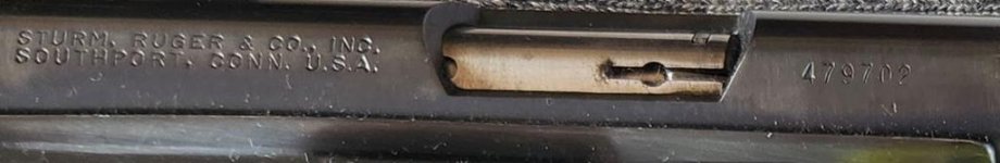

Second question is about the Ruger 22 AUTO? I enclosed information on side of pistol
Any ideas?

Not sure what you're asking about the Ruger Standard Model, but it was made in 1968.
