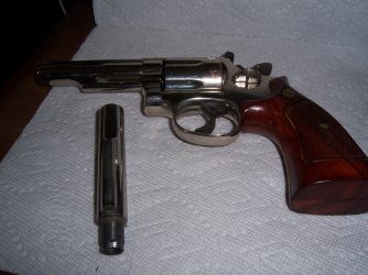

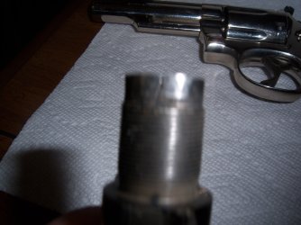

150 gr cast SWC pushed by 13.5 grs of #2400............Happened in 1986.....I rebarreled the gun and probably haven't shot it 10 times since.......I have posted this several times since 1986.
You got the revolver new? You only shot that load exclusively? That's probably a max load today but a few decades ago that would've been considered warm-mild

Bought gun brand new.......No that wasn't the only load i I shot in it........I was never a fan of 110 or 125 gr bullets in 357 so I never used them....Actually that is a very mild 357 load......I still use it.
