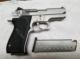

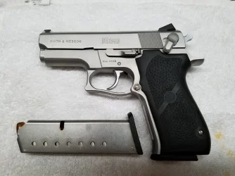

I was the one that posted the round trigger guard 4596 and updated the forum on it. I also got a Jinks letter and TFA3682 was shipped 5/25/1990. I have Attached the jinks letter. In my application I asked Roy to address the round trigger guard and he failed to address it one way or another. The serial number of TFA3682 must be very early in the production and it might be a one off and production changed to square trigger guards. ?? It is certainly a bit of a mystery. I just googled Roy Jinks and he is still somewhat active. Not sure how else I can document this 4596. Does anyone have any thoughts ? Thanks

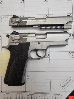

A 4596 is essentially the top end of a 4516 and the bottom end of a 4506. I put one of those together myself and it is my favorite .45 to shoot. There is just something right about that combination that feels good in my hand. I used the original no-dash models for mine, hence the flat-front trigger guard and the machined step in the receiver just below the ejection port.

Since the original thread in 2014, there has been more information uncovered on the 4596. A Lew Horton letter confirmed that there was an order for 500 units, but only 457 units were delivered. The lowest serial number I've observed is TFA3675 and the highest TFA4115. All box ends observed have a Julian date span of 0115 to 0128 (04/25/1990 to 05/08/1990).
Your pistol fits within all these observations, however it includes a genuine round trigger guard and a different laser etching format (the serial number is below the model number, all other observed 4596 have the serial number above the model number).
If I was to guess, the original frame for your 4596 was somehow damaged and S&W replaced it under warranty with a later version of the 4506 frame. It would be interesting if Roy could find the repair record with your second request, if that is what happened.
