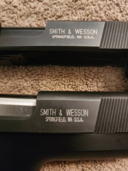

I've recently acquired a 45 CQB slide for a future build, both barrel and slide are in pretty good condition. 20250807_170338.jpgMy first instinct after cleaning them up was to compare them to my 4563 CQB 45, product code 170106. My plan is to build a 4566 based shooter as my other pistol is a safe queen. Several differences were noted between the two,

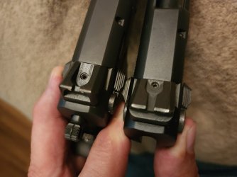

  • Slightly different font and positioning on right side markings.20250807_170448.jpg

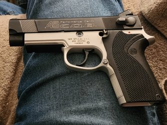

From what I've discovered so far, it appears that the CQB pistols were built on TSW frames, having the forward rails, so my build frame is likely going to have to be based on either a 4563 or 4566 TSW frame. I prefer heavier, steel framed guns so it's likely going to be the latter of the two, but availability and price will also factor into the final outcome.

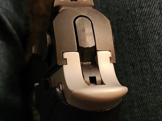

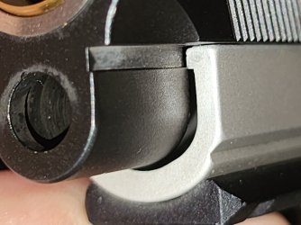

While I haven't started mic'ing or bluing anything for fitment, my preliminary test fitting on my 4513TSW frame has been extremely positive. While not quite as tight as two pieces hand fitted after manufacturing, the rear rail fits are as tight as the original TSW slide. The front rails on the frame are slightly oversize to the slide, nothing that some careful fitting wouldn't rectify. I might be wrong but I'd think that this would have been one of the areas that the PC would have effected their fitting. The spring box on the CQB has comparable clearance to the TSW slide.
Drawing on your vast knowledge and experience, do you know if the slides were the same between the SS and alloy frame models? I don't think S&W made a model 4563 other than the TSW frames. That's not not to say that they didn't produce a special run of alloy 845 frames specifically for these guns, but it seems more logical from a production standpoint that they would have utilized an existing frame.20250808_184855.jpg20250808_185318.jpg20250808_184824.jpg20250808_184835.jpg20250808_183652.jpg
