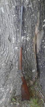

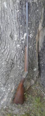

Won this at a online aucton picked it up today. The auction pictures weren't the greatest, but decided to take a chance, got it for $260 total looks much better after a bath. The bore is pretty good considering it was shot with black powder, and there are still some casehard colors showing, and some bluing left on the barrel. I shot it twice with my few rounds pretty much hit point of aim just a bit high, but I was only 25 yards away. The stock will need repairing, but nothing major.Now if someone will just start making 32RF again...
