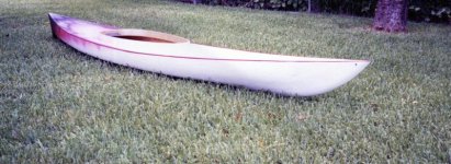

Feather/sand, prep and paint with Rustoleum epoxy appliance enamel.
I use white on our homemade kayaks.
Monitor inspired decks, built in '92.
Red is from a 460ed Great White. :rolleyes:
