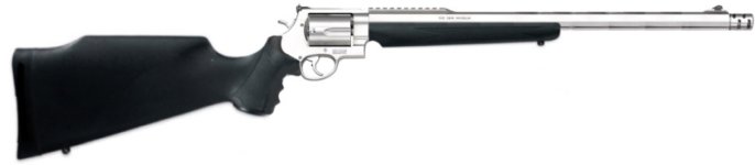

Well, now that Taurus is making the "Revolver Rifle Judge", S&W is Crazy if they do not make a 44 Mag, 460 Mag, and a 500 Mag Revolver Rifle...
Yes, I think we should all pester them daily until they do!
. Scope mounts that you do not have to remove the rear sight to mount the scope...
The scope mount should look like their current 460 hunter from the custom shop and be an integral picatiny/weaver mounting out on the front of the frame/rear of the barrel. Personally, I would mount one of those small reflex type red dots.

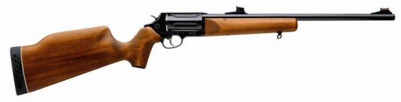

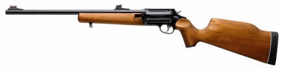

The Taurus 45/410 circuit judge is, from the reviews, a nice gun. However, the Rossi circuit judge in the 22/22mag configuration was an abysmal flop. This is a shame because the idea is a good one, but Taurus/Rossi executed the idea poorly. I would think the S & W could this gun and do it right.
I have a 22/22mag revolver that I like a lot; I can plink and I can hunt with the gun. Unfortunately when I went to get its match in a rifle I ran into a mess.
The reviews for the rifle revolver vary from ok to horrible; most toward the horrible side. The problem is that while Rossi resolved the blow-by, it made a barrel cone big enough to swallow a mag shell, up to 2 1/2 inches deep and so wide that the blast passes the lead and impedes the shot--to the point where the mag shoots at about the power of a regular 22 LR. Not good.
I wanted one of these but I am not willing to spend $600 for a good try. It seems like the idea a good one and that Smith & Wesson could do it right. The demand is certainly there since the internet is replete with reviewers who gave the Rossi a run.

Also, have you seen the blast guards on the Rossi rifle revolver? They look a little strange but seem to work and might be added to your project.

How about this, what if I found a used Rossi, purchased a bolt action barrel and had the cone drilled by a machine shop? The cone seems to be where the problem is.
The problem might also be that if the Rossi cone were not so deep and wide that the blow-by would be horrific. One of the reviewers had written Rossi and demanded his money back; the response was that the gun operated according to its design. I may be looking for something that is impossible. Darn.
