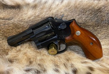

My very first ever OGCA show must have been maybe 2011 (I am guessing here, I could be off on this date) and I came across a table holder offering a 547.
I had never heard of it, the seller gave me a basic description and it was interesting, but not so interesting that I was will to pay the $400 he was asking. 🤦‍♂️
Here is the paper S&W included in the box with the 547. In the last couple years folks brought to my tables one each, 3" and 4". I have seen a few come through and $1400 seems to be the going rate around here for high condition examples. Triggers do seem a bit heavy but mostly I don't like the stubby hammer spurs. S&W's attempt to make a revolver shoot rimless cartridges without moon clips died on the vine like the over complicated Straight Line (4th model Single Shot).IMG_1045 (2).JPG

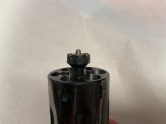

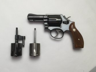

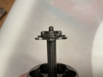

Here is a Model 13X 9mm prototype mfg in 1975 { future 547 }
Cylinder in the white has a wire spring extractor without cartridge stop in chamber, 2nd blue Cylinder has the cartridge
stop milled in and has spring fingers that grip the extractor grooves would the become the upcoming 547 system.
The cylinder in the gun has the wire spring system and the cartridge stop milled in.
Model 13X   experimental 9mm  for the later model 547   with Cylinders.JPGIMG_0093.jpgIMG_0092.jpg
