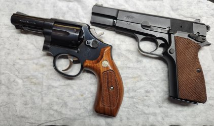

as required here is an obligitory bench pic, disassembly and cleaning to follow.

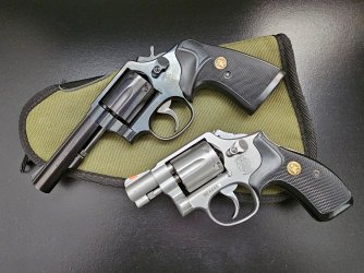

Not surprised at the more like .357 than .38+P recoil. In addition to the 3" 547s, I've had some other 2" and 3" revolvers chambered in 9mm. The 9mm cartridge seems to be very efficient in revolvers, and generates more velocity, energy, and attendant recoil, than many might expect.

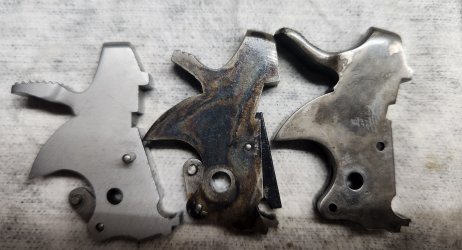

So a K22 hammer will not work in a 547 for two reasons.
First the 547 hammer stud is larger diameter .165" vs .140 " on K22 as well as an L frame hammer I just measured.
Also,
The hammer face is cut very different , the K22 has a visible shelf at the bottom of the hammer face.
Pic attached below,
Left to right 617 hammer, 547 hammer (center) K22 fishhook hammer.

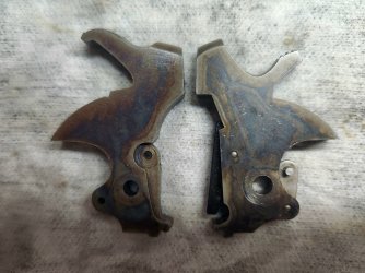

Ok another update,
By chance I happened to notice a pre war K22-40 hammer in my spare parts bin and surprise ,
the hammer faces are pretty darn close.
Problem is the K22 hammer stud is of course smaller and the pre war sear is totally different.
K22-40 (left) 547 (right)
