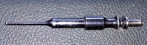

Maybe the back of the firing pin isn't sticking through far enough?
Firing pin seems ok?, the end is rounded? If the gun is in battery position it should not have light strikes even with cut recoil spring. I think there might be the wrong, or cut main spring. I'll keep checking back.
Regarding the firing pin, I don't know what to look for.

I guess it could also be the firing pin. When I get that off, I can measure the length, but if that's what is wrong, are new firing pins available?
You are saying the tip of it should be rounded? I'm not sure how to get a photo that would show this.......

The slide swap probably not a good idea yet. Frames and slides are fit together in the "white" before finishing and bluing. might not fit right. I was talking about the other end of the pin. does it look like your other guns pin tip and protrude as far? Concerning the frame assembly. With the slide off cock the hammer. squeeze very slowly on the trigger. Do this a few times. Does it fall into half cock? I wish I could pick that gun up! I have other things but I'll wait and see.
Looking at the picture of that firing pin, It looks almost flush with the safety' It should protrude enough for the hammer to strike it. What do you think?
Did you remove the safety and firing pin to clean? If not there may be debris not allowing the pin to fully return.

UPDATE, firing pin will arrive from Brownell's tomorrow, Wednesday.
Once the firing pin is forward a slight tap while pulling the safety. Once it moves out a little rotate slightly and pull out.....
.....I push the firing pin in with a punch that fits and hold it in . Then i use a pair of locking forcepts (SP) to grasp the protruding end of the FP......lock the forcepts and they will hold the FP while you remove the safety......

Don, you wanted to know about the firing pin. Looks perfect to me, the end of the pin is smooth and polished feeling. Here's a photo - maybe you'll see something that I don't....
