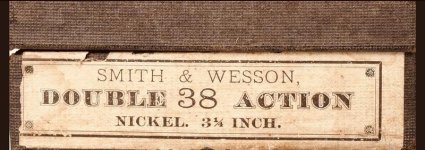

Hey Mike,
I have some pretty good research material on the SA and DA boxes for the 32's and 38's. Let me just say first that there is no solid method to date the early boxes. The post 1900 boxes have a distinct label change seen in the last photo. So all of this is theoretical only based on what I've found over the years.
Photo one is the early deep orange label. Notice the pattern/design and the use of capitol letters in ACTION
This would be the model 1 DA straight cut side plate and model 2. Also likely early model 3's but very early only.
If you look at the OP's label it's the later label design but still has capitol letters. So still an earlier box from my research.
Photo two is the cream color orange label with a capitol A and small letters following. That from my research is the later label post 1895ish. The last of the antique boxes or very close to it.
The last box is an excellent example of putting the wrong mint gun into a late box. That's a model 2 inserted into a post 1900 mint box. Looks nice but it's not a matched set by no less than 20 years. That part is not theoretical. That's definitely a late box.
Murph

Aah, I believe you were referring to the label being "cream-colored". I was hung up on the BOX being cream-colored and was thinking I needed to add another to my collection. BTW, nice boxes.
Thanks Mike,
I'm sure glad I bought into boxes years ago. I'm priced out now. I still think original boxes are a solid investment.
