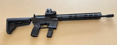

Photo of my S&W Response with newly installed flash hider. Also installed Rise RAVE PCC trigger 3.5 Lb single stage. Nice improvement.
Also a couple targets from yesterday, aligns with what is spelled out above. EOTECH 1X is max @50 yards for my vision.
Thanks for helpful information.
