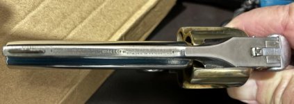

I inherited a large collection of firearms from my father. I would greatly appreciate help identifying this cool little Smith and Wesson handgun. This is what I believe I’ve learned from research:
Safety Hammerless 5 shot revolver
Model of 91 (top of barrel)
Double action
3.25 inch barrel
.38 caliber
Top break
Serial number 118xxx ( bottom of handle and cylinder)
Finish: nickel with gold cylinder, trigger, and safety bar)
I would appreciate any information you can provide. I’m particularly interested in the exact model and manufacture date.
Thanks!

Hi There,
What you have is S&W .38 New Departure 4th Model. The barrel
is from another model. The Fourth Model started at serial number
116000 and the change over to the Fifth Model was somewhere
around 220000 (exact serial number is not known).
The barrel is from a S&W .38 Single Action 3rd Model (a.k.a. Model
of 91). The barrel latch is from the fourth or possibly fifth model
New Departure.
Now the question is: did S&W put that barrel on it? Look behind
the barrel latch into the cutouts for the frame posts and look for
the serial number. If the serial number matches, then it is a Factory
installed barrel. There is also a serial number stamped on the
underside of the barrel latch and on the back of the cylinder.
These should all match the serial number on the frame to be
all original.
Also, does the serial number have a star stamped after it? If so,
it means it went back ti the Factory for repair and/or refinishing.
Depending on when it was sent back, there could be a number
stamped under the grip panel that would be the date it was re-
ceived by the Factory for said repair/refinishing.
Cheers!
Webb

There is a serial number on the barrel. It resides on the flat or flats where the latch rotates. Its hard to see, you need to lift the latch to see it better.
I have a 38 double action with a model of 91 barrel marking on the barrel. The serial number on the barrel matches the double action frame. I have seen 3 or 4 like that, but only on double actions.

Boulder350, thanks for that information. It looks like the number on the barrel is different. I'm uploading another photo showing the numbers on the cylinder and latch, which match, and the different number on the barrel. Assuming I understand correctly. Hahaha!
New photo added. Serial number on the latch and cylinder 118,008.
The other number on the barrel is difficult to read but is 5013.
What would have been the advantage of using the barrel from a Model of 91 in place of the normal barrel? Is it possible that it came with a different length barrel and a previous owner simply switched them because he wanted a shorter barrel?

Hi There,
Make sure you check Both right and left barrel flats for numbers.
Normally, the barrel serial number is stamped on the right-hand
barrel flat (like my pic). There is a slight possibility that your barrel
was a Factory take-off that was re-used on another revolver. If this
is the case, S&W will stamp another serial number on the left-hand
barrel flat.
Cheers!
Webb
Edit: You posted you pic while I was typing this reply.
Unfortunately, it appears that the barrel is an non-
Factory barrel swap.
Hi There,
To answer a couple of your questions, I would say your revolver
was probably made in 1898. The value is subjective. The New
Departure generally is not a high value collectable (unless it
has unusual markings or a rare barrel length).
The barrel was change for a couple of possible reasons. It could
have been to change from one length to another or to replace a
barrel with a badly corroded bore.
Cheers!
Webb
