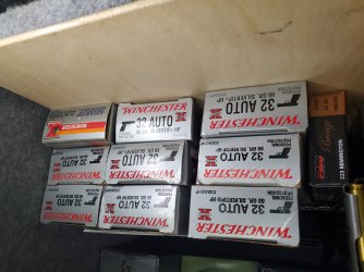

Hi, had one years ago with four magazines, three of the mags worked perfect with PMC 32 hollow point, the other mag not so much, pictured is some of my old PMC with a silver tip ............Target sports has PMC 32 hollow point ammo cheap !.....hope this helps
