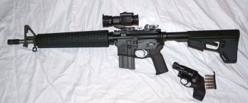

I like a red dot sight, co witness along with a flip up mil rear sight. works very well.
