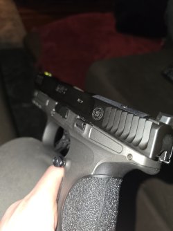

I picked up this M&P performance center 2.0 metal (Competitor) 2 days ago. Its brand new. I took it shooting yesterday and experienced a misfire twice, firing pin not making contact with the primer. I realized the slide wasn't going back in to place completley leaving about a quarter inch of the slide still drawn back. I sat there for an hour loading mags in my house and just racking them. Realizing I have to pull and release unrealistically hard to get it to go into battery on the first pull, somthing that my girlfrends m&p compact does not experience at all. Anyone else had this issue with their competitor? I did add a little more lube to the slide last nigh1000002522.jpgt and it made no difference.

It happens with any type of ammo, I did have a misfire with Winchester white box but that was a dud so i wint be using that anymore, is there a specific type of ammo these guns need? No It is not limp wrist im saying when I use my hand I have to slide it unreasonably hard to get it into battery. These slides are supposed to be super smooth because the frame is metal.

I haven't cleaned barrel, its only on initial slide, it dosnt go into battery manually sometimes. I know you're thinking just slide it harder, but its ridiculous how hard I actually have to I know its not right. These slides are supposed to be smooth because the frame is metal.

In my own experience, new guns can exhibit this issue. Clear the weapon (no rounds, no mags, from "in battery", pull the slide back about a inch (like doing a press check). Ease the slide forward (do not push). It may "hang up" slightly out of battery. This is where the locking lug begins the slide up the locking block, push the barrel into the port to lock the barrel. With a round in it (try with a snap cap, not live round unless at the range) the rim needs to slide across the breech and under the extractor. All of this adds a bit of friction and can be more than the spring force from the recoil spring can overcome to fully seat in battery.
A "slingshot" release allows the slide/barrel to have enough momentum to carry the whole thing into battery.
My Shield (1.0) was pretty bad like this when new until I had a few hundred rounds through it. Pull it back just until the barrel unlocks, let go, and it would just sit there. Could easily push it forward to fully lock but you could feel the resistance.
Some good clean lube helps too.

Had same problem with M&P 2.0 in 9mm. Tested with swapping slides, magazines, 5 different types of ammo, lubed it, serious lubed it, nothing corrected it. Sent it to SW warranty, waited 6-7 weeks to get it back, same problem existed. Sent it back to SW warranty, waited 8 weeks this time and it came back with paperwork "replaced barrel". Ran like a top after two trips back. SW has had some QA/QC issues here lately. Save time and frustration, let them fix it
