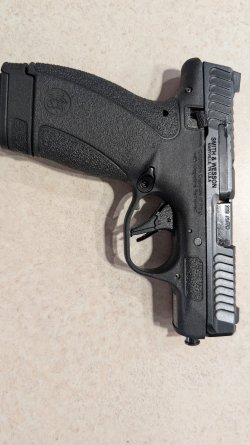

Howdy all.
Just got the .380 bodyguard 2.0.
But about 150 round through it after an initial cleaning, but having some issues with the slide and a strange stiffness or seating issue.
If carried or manipulated in any way, I've noticed that it won't fire and the cause seems to me that the slide isn't all the way forward and it's back about 1/8 of inch or less and has to be nudged forward before it will fire.
This stickiness I thought was spring related at first but after cleaning and really playing with the bodyguard, it almost seems as if the slide is rubbing against the polymer lower in some way (like they aren't a great fit for each other) holding the slide slightly back from proper seating.
This only happens when the gun is jostled around some. When using the slide release catch or racking the slide and inserting a new round it seats just fine. Picture shows what it looks like after not seating properly. (With spring piece jutting out farther than it should)
Anyone else seeing this issue or something like it?
It appears the end cap of guide rod is protruding too far out of the end of the rod tube.
The end cap is a design flaw, in my worthless opinion. It should have been threaded instead of a compression fit with a short knurled shaft.
S&W Customer Service should send you a new one.
A group of us own the BG2.0 and some came with a tighter chamber than others, which caused the slide to not go fully into battery unless whacked into place. I was able to hone the chambers with a carbide impregnated ribber Dremel bit to hone and polish it a few tenths of a thousandth and they all run 100% now.

You might solve this with trying different ammo, cleaning it very well where it seems to be binding (per above), or just "a lot of use". The "lot of use" is more expensive. I used to have this, but I think to a lesser degree. I have been trying different ammo, cleaning it regularly, etc. so one of those might have helped.
I think a lot of individuals will be hesitant to hone the barrel like @agksimon did, but I'm sure he is onto something.

Extractor is hanging on the case head resulting in FTF.
Feed only from the magazine. The extractor is designed to slide into the extractor slot.
It’s viseably out of battery. If it fires out of battery it’s a Ka-boom! Firearm and bodily damage possible!
Slamming it shut can and will eventually cause extractor damage and failures to eject.
Your RSA (recoil spring assembly) isn’t seated correctly. Unfortunately the RSA is a recurring issue with these guns. I called Smith and they sent me a pair of extras. Unfortunately they were identical to the supplied ones and had the same issue. The good news is I read/saw/found a reliable way to solve this issue. Still annoying but easily remedied.
When you reassemble the slide the RSA will either click quite easily and normally onto the ledge on the bottom of the barrel or it won’t. If it easily seats onto that ledge/step then just reassemble the gun as normal and the front of the RSA will protrude a tiny amount (about 1/8”) which is normal.
If it does not click onto that ledge then look at the front of the RSA. The end of the recoil spring will be overriding the lip to some degree. If you simply pull down on the spring and simultaneously push the edge back under the RSA lip when you try it again it will click in easily as it should. S&W better be working on a fix for this because RSA’s aren’t exactly bleeding edge tech.
It is easy to fix though as I described. I have used that method on 5 guns that I have had at my disposal and it has always worked. Hopefully my description is adequate because this is one problem I have crossed off my list.

The more you read about the BG2.0, the more you find the slide sticking and not completing going into battery. I confirmed it in my case by just running the slide back and forth on mine (unloaded, of course) for hours on end until the slide didn't stick. Anybody who gets one, I strongly advocate spending many evenings running the slide back and forth until it's smooth (you can feel it actually stick). If you have a safety, same thing. Broken in, it works like a charm.
