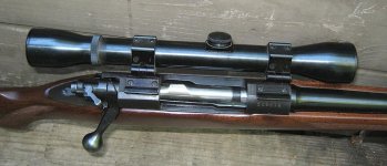

Another option would be one of the old Weaver swing away scope mounts that allow you to swing your scope to the left, and use your iron sights. I have one on my old model 70 Winchester, and it is reliable, strong, and holds zero very well.
Larry
