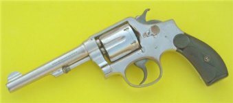

I picked up #144509 at a local show today. I'd like to enter it in the highest serial number contest. According to Mr. Jinks, there were little more than a hundred more made after this one.
Wow! I didn't think about ammo for it being as expensive as it is.
Is the Blue Book close on the value of these things?
David Carroll has a 5" gun with 144583 on his web site for sale. Guess thats 72 guns higher than yours. I wonder if the short barrel examples were sold out by the time they made yours and his, so some went back into production to satisfy demand for them. Long barrel guns might have still been in stock, so they kept pulling those for sale instead of producing them.
So in the last produced game you're playing, maybe it would also help out to state barrel length along with the high serials.
As you can see, mine is a 4". 144583 is sure enough a late one.
