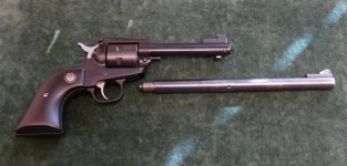

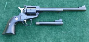

I had bought a 7-1/2" stainless Single Seven when they first came out and hoped they would bring out a .327 in blue with a 9-1/2" barrel. After a couple of years I decided that wasn't going to happen so I decided to make my own.
I bought a blue 4-5/8" Single Seven Ruger(R) New Model Single-Six(R) Single-Seven™ Single-Action Revolver Model 8165 and found a 9-1/2" .22 barrel on eBay. I sent the barrel out to be rebored to .32 caliber and took the gun and barrel to my local gunsmith back in February. After about four months I decided I should call and check in.
Turns out they had called me in March but for some reason the message didn't come through. The threads on the Single Six barrel were smaller than the Single Seven barrel so it wouldn't just screw right in. Dang! So we decided he could cut off the threaded part and rethread to the new diameter and pitch. That's why it's an 8-3/4" and not a 9-1/2".
Here are the before and after pictures. Please excuse the difference in lighting. You can readily see the difference in the barrel threads.
As you can see the shortened barrel cuts into the warning label some. I had thought about having the barrel clocked to put that on the bottom but that would have meant that the old ejector rod housing screw hole would be visible (it is now under the housing). Likewise for the front sight screw hole.
