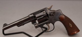

Hi Gang,... hope all are enjoying the long hot summer so far.... Just got this ole S&W 1903, and would be great to get any info you guys would like to share, including born date.... thanks,
Model 1903
chambered: 32 S&W Long
serial number: 354096
Hand ejector
barrel 4.25
4 screw...

Hi,... thanks for the comment, yes the serials are close. The "Regulation Police", is that what they were called un officially, or is that a term Smith & Wesson designated officially?
The round butt version was officially called ".32 Hand Ejector". The square butt version officially called ".32 Regulation Police". It is somewhat confusing due to the fact that the RP has a "round" butt, but it also has a cut rebate in the backstrap for proper fitment of the extension grips.
Pics show the difference in the backstrap.

That’s a a nice one! It’s a 6 screw. Although the front grip strap screw is not counted until after WWII just before it was eliminated.
I do not see a MADE IN USA roll mark on the right side in front of the trigger guard so it’s likely from before 1923 or early 1923.
The same gun in 38 s&w is marked REGULATION POLICE on the barrel but the 32 RP was not. I believe because the police were the intended market for the.38 chambering.
What is the frame designation? of the 6 screw?///
Your blueing looks outstanding, esp. on the R side.
Wait,... even with the screw on the front strap, that is still only 5 screws.... where is the 6th screw?
It is an I frame.
The sixth screw is in front of the trigger guard.

In front of the trigger guard.
Jim (Hondo44) may be back soon, but as he noted above the "six-screw" phrase really only refers to the early post-WW II I frame era. For a few years, these had the old-style leaf mainspring, and therefore a strain screw. After the coil mainspring was introduced, no need for the strain screw, so the (collector's term) screw count goes from six to five.

Patent Date on Stocks
I learn something new on this Forum almost every time I read the Threads! For instance, I never knew that S&W stamped patent dates on the bottom of their stocks like on the OP's revolver. Was that only on the very early models of DA revolvers (e.g. Model of 1903), or did it continue for a while? I've never seen that before.
It was a patent date for the Regulation Police stocks.
Ditto to Hawg's comment.... I had never seen that before. It was so neat and precise of a printing,... it almost looked Photoshopped in.
The 1903 model I frame has the same 6 screws in the same locations as the post war Transitional I frame. The next change, the Improved I frame replaced the leaf mainspring with the coil spring and the spring tension screw of course wasn’t needed; it’s the 6th screw because it was eliminated 1st leaving 5 screws on the I frame.
When the Improved I frame with 5 screws was replaced by the Model of 1953 New I Frame, the 5th screw in front of the trigger guard was eliminated and became a 4 screw. The 4th screw at the top of the side plate was eliminated last on the I frame.
Notice the screw numbers are different from the K and N frames:
They never lost the 6th screw (and therefore it’s not counted) and because the 4th and 5th screws were eliminated in a different order.
