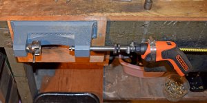

Case length trimming
Bungee cord extraction,weak enough to just pull out by itself but still no effort to push in.

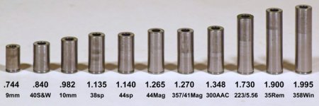

Trim length adjustment
I hate adjust,trim,measure,adjust,trim,measure. Made a set(for the many cases I trim) of 'Master case length gages'. They were made to SAAMI minimum spec. Insert the 'master' into the case holder,run the cutter head(less pilot) up to the 'master' and lock down. Works perfectly. If I want a different dimension(longer than SAAMI spec) I use a automotive feeler gage between 'master' and cutter head.
